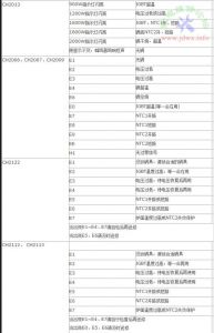

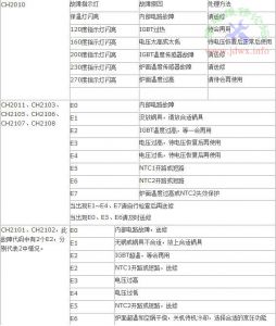

    发表于 2016-6-10 20:37:59 | 显示全部楼层
    海尔电磁炉代码维修手册
      {9 b- A: H5 u9 G* k* T 114832su3kup9s29puu31x.jpg
    ) r+ V' [# K/ X* J 114833juw3oc3r33xfyefc.jpg
    3 a, Y% H9 P/ z7 c* R1 z 114833ssqavzl3ddqqqprl.jpg
